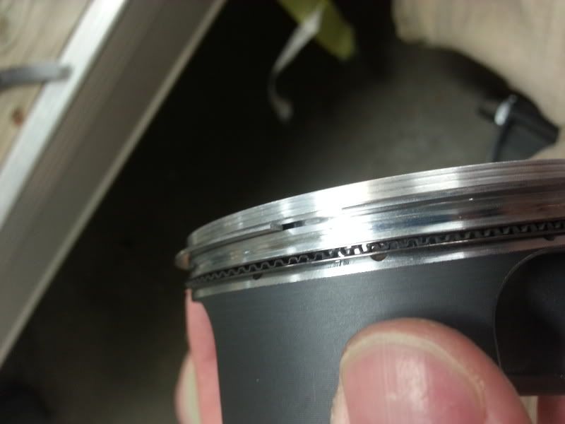

My Piston came with 2 top rings and an oil ring but there's only grooves for one top ring and the oil ring. There's a groove in the middle but it's a lot more shallow than the other 2 grooves and won't fit the 2nd ring.
What do I do now?
#9 ·
ya thats how the pistons come. you just use 2 of the 3 rings. and hang the other one aon the wall untill you get tired of looking at it and toss it

I wish I would have went a little tighter on the top ring gap then. I didn't realize I bought a MX CP piston. Mixed feelings on that one... Kind of hard to do anything about it now that the jug was matched to this piston by Millenium Tech.

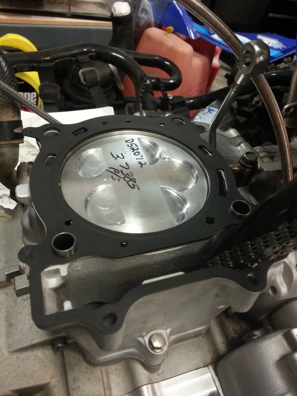

Well I got my new rings and this time I set them at .015" per CP's recommendation. Once I get that G*&^%*%^ timing plug out of the case. I ordered a 14mm hex socket that will be here tomorrow. That thing is in there TIGHT! I stripped the small one removing it too but replaced it already. I don't think they've ever been out and the cam mod wasn't done so it doesn't surprise me. So how long does the break in process take on these? Do I have time to let the bike warm up before I give it hell or do I need to get on and mash it right away? lol

The piston is most likely not at TDC since I can't get the large timing plug out of the motor. I have a 14mm hex socket coming tomorrow which should work and I will check the deck height when I can spin the crank and see the timing marks. It's an OEM 07 crank and cyliner in an 07 motor with oem gaskets so there shouldn't be any issues. I have new copper washers for that oil line that you're talking about. You're saying I should start it w/o that torqued down and let it bleed for a minute? So excited to get this running. New piston, fresh jug, new pipe, and I only had one ride last year on my new FCI intake so it's gonna be a big difference I hope.
